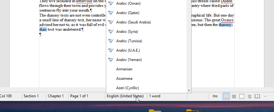

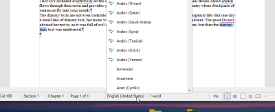

And for the way via Status bar, see screenshot, where it should be placed by default.
If it is not there, you can also add this command to the status bar via Tools > Customize (search for "Current language" command on the top left of the Customize dialog box).
