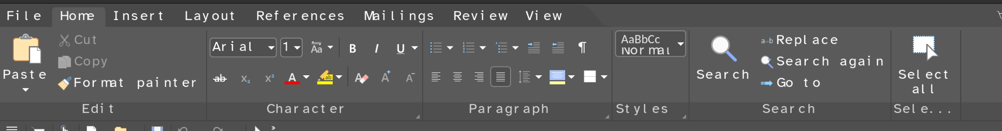

After an install from the official repo, all freeoffice application do not use the right font for the interface. The spacing between characters is all off. I cannot find an option to change the interface font or to find which font needs to be install and accessible :/

DiseasedPigeon wrote: Mon Mar 17, 2025 10:44 am I cannot find an option to change the interface font or to find which font needs to be install and accessible :/
While the specifics of your system and configuration are important, I only encountered similar problems when a requested font had not really been available. I suggest to find the setting in Fedora that imposes a font for the GUI and *change it* to anything that you can possibly live with in the future. Only if then, the phenomenon persists, I would call it a SoftMaker related problem.

Right, changing from Atkinson legible to Liberation solved the issue
