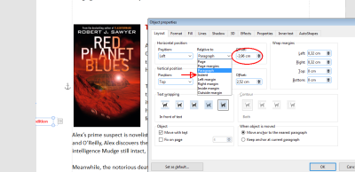

"The position of both text boxes says 3,56 cm left of the column, and the question is now where the column starts. As the document is a single column, TM assumes the left page margin. Word thinks it's the position where the text starts after it has moved because the image blocks the regular place.
Basically, there are two methods to solve the problem:
#1: Set the position to 'relative to indent', as seen in the screenshot (restore the old offset value)
#2: Don't rely on the Word method of placing two objects independently, but 'group' them so that you have only one object.
(#2 is the better method)" See the screenshot for reference.

I'm sorry, but the most-used word processing software in the world, by an overwhelmingly HUGE margin, is Microsoft Word. Everyone else promotes their word processor by claiming how compatible it is with Word. To be informed of an obvious incompatibility and to then suggest going through a somewhat laborious procedure to correct what is fundamentally a program flaw by editing the document is not acceptable.raitis.veksejs wrote: ↑Thu May 11, 2023 5:27 pm I got a reply from our developers' team:
What happens if he makes the changes to the document that you suggest, and then sends it back to a colleague who is using Word? Are the captions then going to display incorrectly in Word? If so, that's not a solution. Even if they display correctly, if the colleague notices the change and restores it to the way he, as the author, thinks it "should" be -- what then?
