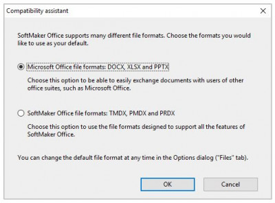

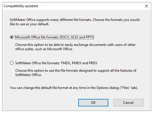

Where do I find the "Compatibility Assistant" touted in the Softmaker blog? I have been searching the TM 2018 menu's for the Compatibility Assistant, but no luck. With this assistant one can make quite sure that all of your files will by compatible with MS Office.
Softmaker 2016 & 2018.
Re: Saving as .docx with TM 2016 and saving as .docx with TM 2018. What is the difference?
It's quite well hidden: File > Properties..., tab "View", button "Compatibility...".ecbritz wrote: ↑Sat Jan 13, 2018 1:54 pmWhere do I find the "Compatibility Assistant" touted in the Softmaker blog? I have been searching the TM 2018 menu's for the Compatibility Assistant, but no luck. With this assistant one can make quite sure that all of your files will by compatible with MS Office.
Edit: Sorry, I misunderstood your question. The "Compatibility assistant" dialogue box you referred to is only shown during installation (or when saving a document for the very first time – I'm not quite sure about this). To change the default file format afterwards, go to Tools > Options..., tab "Files" (as announced at the end of the box). There is a list box "Default file format" (with even more options).
