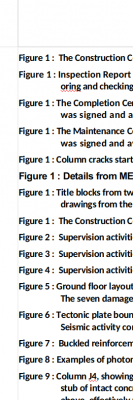

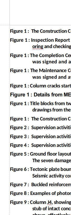

This problem is getting far, far worse now.
In addition to two tables, both called 'Table 1', TM has numbered no fewer than
EIGHT of my 28 captioned figures, all as 'Figure 1'.
See partial screenshot:
