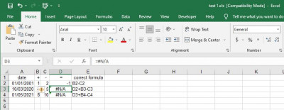

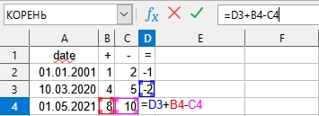

When I open with recently installed Planmaker an xls table which has been created or modified with LibreOffice, wrong cells numeration appears in some formulae. E. g.: "=D2+B3-C3" becomes "=G4+E5-F5" (please see attached example file). The issue affects:
- only xls files (not xlsx nor xlsm);
- only files that were created/modified using LibreOffice (v.7.3);
- only formulae containing cells from different rows.
What happens?
Upd.: I will attach also 2 images showing the problem.
What happens?
- This is what I see in LibreOffice
- LibreOffice.jpg (33.73 KiB) Viewed 102156 times
- test 1.xls
- This is a test file created with LibreOffice
- (6 KiB) Downloaded 6224 times

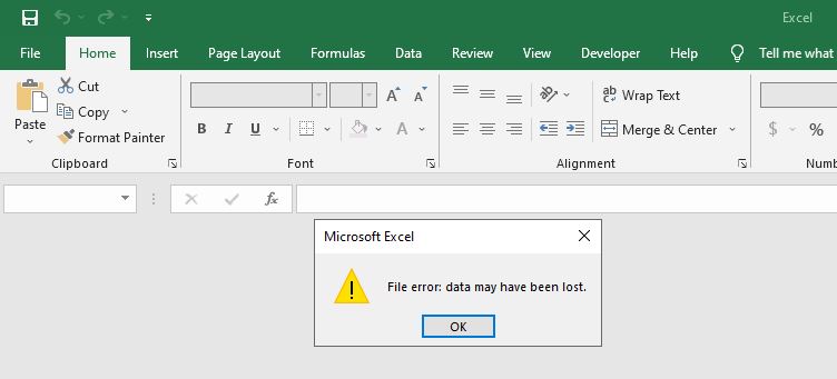

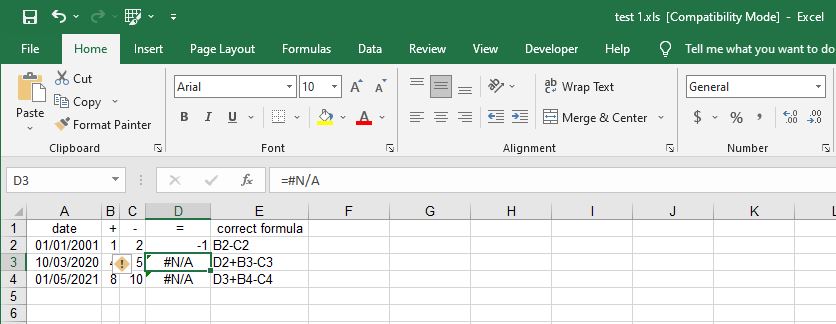

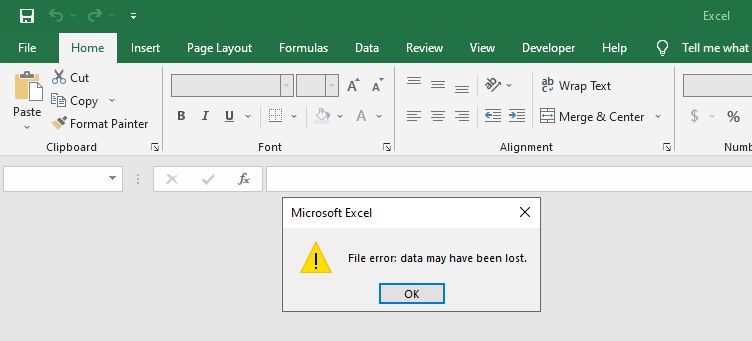

Thanks for posting your problem with sample file and screenshots. But the file you shared is corrupted from its source (LibreOffice) itself as when I tried to open it with another software, Microsoft Excel, I got error and both these formulas are corrupted.
Please check attached screenshots for your reference.
To repair this file, I opened it with LibreOffice Calc 7.2.6.2, saved it, and now it's working with both PlanMaker and Excel so, you can contact to LibreOffice support/forum for this problem.

SuperTech, thank you for your answer. It took some time for me to re-check the problem. I downloaded my own file and went on experimenting with it. The result is:
1. This file isn't corrupted; whatever the latest version of MS Excel (I don't have it and can't check) could say, the other programs don't complain about any corruption. BUT still it is opened with errors.
2. I've tried WPS Office, Apache OpenOffice, Corel Quattro Pro (trial), MS Excel 2007, MS Excel Online, Google Tables etc. Most of the programs have shown different errors in the formula. Our Russian programmers IMO won this contest for incompatibility with LibreOffice: in MyOffice, '=D2+B3-C3' became a monstrous '=A1048576+XFC1-XFD1'. The only office app that worked fine was, curiously, OnlyOffice.
3. Most of the apps I've tried have shown good compatibility between them, with minimal issues regarding cells format or table layout. Also, tables which were created in other apps are opened w/o any problem in LibreOffice. As said before, the problem only appears in *.xls files, *.xlsx are not affected. But: the only program that didn't want to open correctly an *.xlsx from LibreOffice was Quattro Pro.
So, I see that you are right: the problem should be addressed to LibreOffice developers. Sorry for bothering.

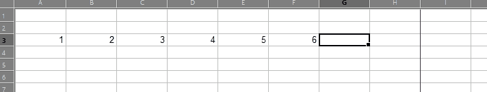

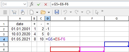

Minor issue #1.
When redacting a cell with "Left cursor never exits..." function activated, it becomes practically impossible to include in a formula several cells on the left side using cursor or mouse, because all the text is being displaced towards the left side and covers adjacent cells. Please see attached screenshot.
- 20220721_202037 [PlanMaker - cell redacting].jpg (18.16 KiB) Viewed 102011 times

I didn't find any problem in left key press while adding multiple cells in the formula. Please check this below screen recording for your reference.

Thank you for your reply.
1. But your example doesn't reproduce my issue. AFAICS, you hadn't activated the function "Left cursor never exits cell redacting", otherwise you could never select cells on the left with cursor. Furthermore, in your example the cells are wide, much wider then those from my example. In my screenshot one can see clearly how the formula is overlapping narrow cells on the left. I could only select "D2" from above and "B3" from the left, but "C3" became absolutely inaccessible for me by any means, neither with cursor nor with mouse. But, if you don't see a problem here, I don't know what to say.
