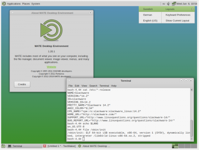

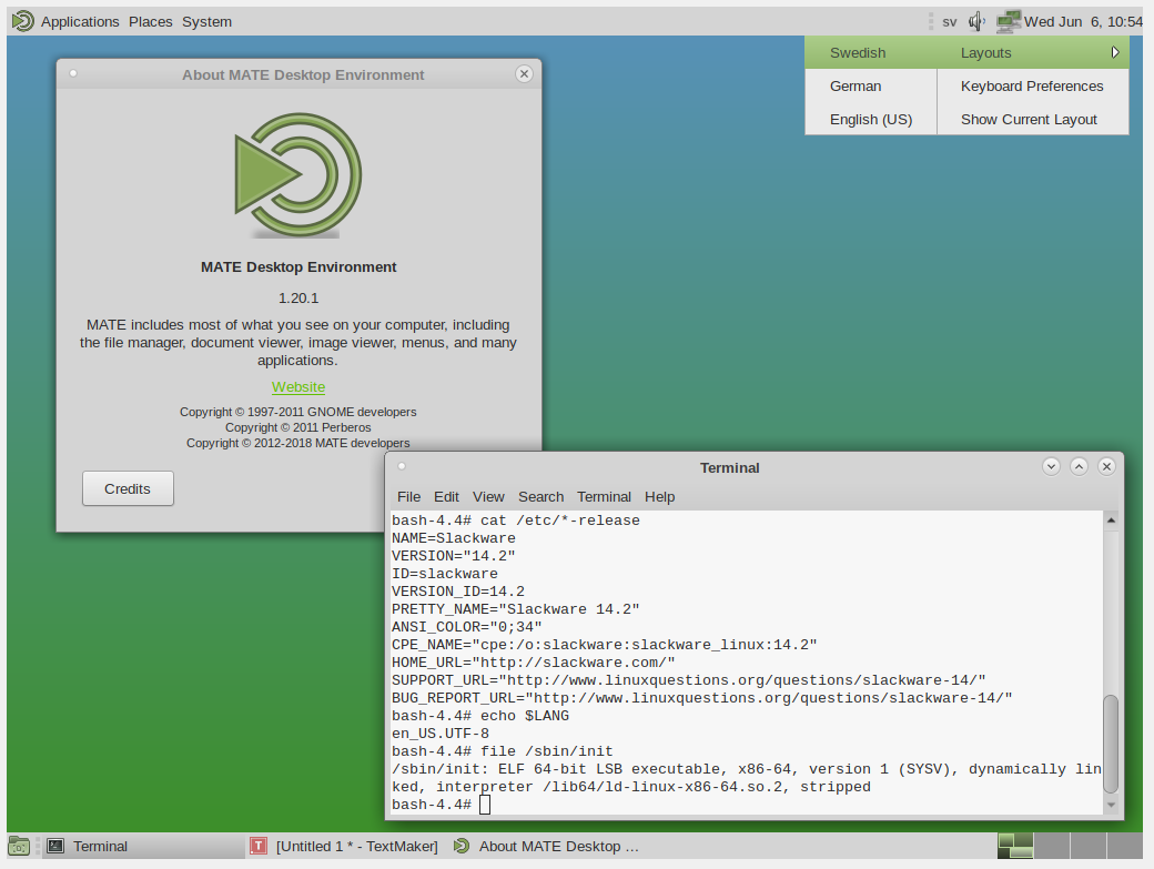

We tried reproducing the issue with your very environment. We set up a test environment as follows:kgha wrote: Tue Jun 05, 2018 3:09 pm 1: Slackware -current 64bit, MATE desktop (no KDE stuff installed)
2: System language English, no particular regional settings except for clock (CET), Swedish keyboard:
3: No other tools installed affecting the keyboard
4: Example, acute/grave accents: the accent key is the same on Swedish and German keyboards. I hit the accent key (shift+key for grave accent) and then the letter key, e.g. " '+e " which ought to come out as é (as here, and in every other program) but in Textmaker comes out as 'e. Same with à bientôt (`a bient^ot), while Citroën comes out as Citroen.
1. OS: Slackware 14.2 (64-bit) with MATE 1.20.1
2. System language: en_US; keyboard language: Swedish
3. No additional tools were installed.
4. Both typing accented characters via "<accent key>+<character>" and using the compose key worked without any problems. For example, "´+e" becomes "é" and "SHIFT+´+e" becomes "è".
So unfortunately, we were still not able to reproduce the problems you describe.
Please find a screenshot attached which shows the specs of our test system. Maybe you could have a look and check if you find any differences compared to your system so we can figure out what might cause the problems.

Re: Problem with Brazilian Portuguese characters
Thanks, n-p, for your efforts.
I see no significant differences in outputs of cat /etc/*-release and file /sbin/init :
I can disable/enable XIM, makes no difference.
Don't know if the information in this old post is of any help - a 'workaround' that unfortunately creates other problems:
viewtopic.php?f=260&t=16658#p56775

VERSION_CODENAME=current
bash-4.4$ file /sbin/init
/sbin/init: ELF 64-bit LSB executable, x86-64, version 1 (SYSV), dynamically linked, interpreter /lib64/ld-linux-x86-64.so.2, stripped
